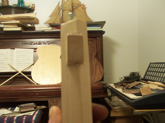

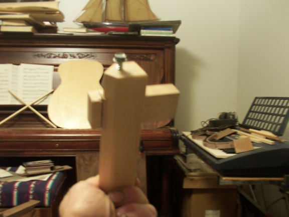

Here are a couple of shots of the gramil I came up with this evening.
I used Mike`s illustration for the basic principle, but after mounting the blade and trying it, I found the blade wandering off track and following grain runout (not good).
Therefore; I thought about cutters and decided to shape my blade just like a saw blade with a flat cut on the bottom and a raked angle toward the waste (not waist) side. A single toothed saw, if you will. Works very well! Took a little practice and technique, but I won`t be intimidated by the thought of a router getting out of control or set up wrong anymore.

I only use a purfling cutter on portions of my bound headstocks and around where the end graft joins the purfling. I bought my purfling cutter from martin years ago, but the princples of using a cutter is the same. If
your blade wanders you are taking too deep of a first cut.
I think you need to set the depth of cut very shallow, just barely scoring the wood. Then set the blade slightly deeper with each successive cut. The first cut acts as a "guide" for the blade in successive cuts.

That`s what I was thinking at the time myself, Paul. I also thought the blade I was using was too thin and flexing. I forgot to mention that I ditched the thin blade and worked down an old utility knife blade. I just knew I kept those things in a jar for some silly reason!
Now that I`ve worked on technique instead of just making something work, I will probably try the origional single bevel knife cutter again. Actually, what I came up with tonight is a variation of a rabbeting plane.
